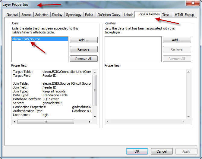

In arcmap > layer properties > join & relates tab (see pic below), there is a set of controls used to setup a Join.
What ArcObjects are used to implement this?
The reason I'm asking is because I'm traversing the objects in a mxd file, and I need to determine whether this join is setup or not.

I believe the join is represented by this property...
IDisplayRelationshipClass.RelationshipClass
