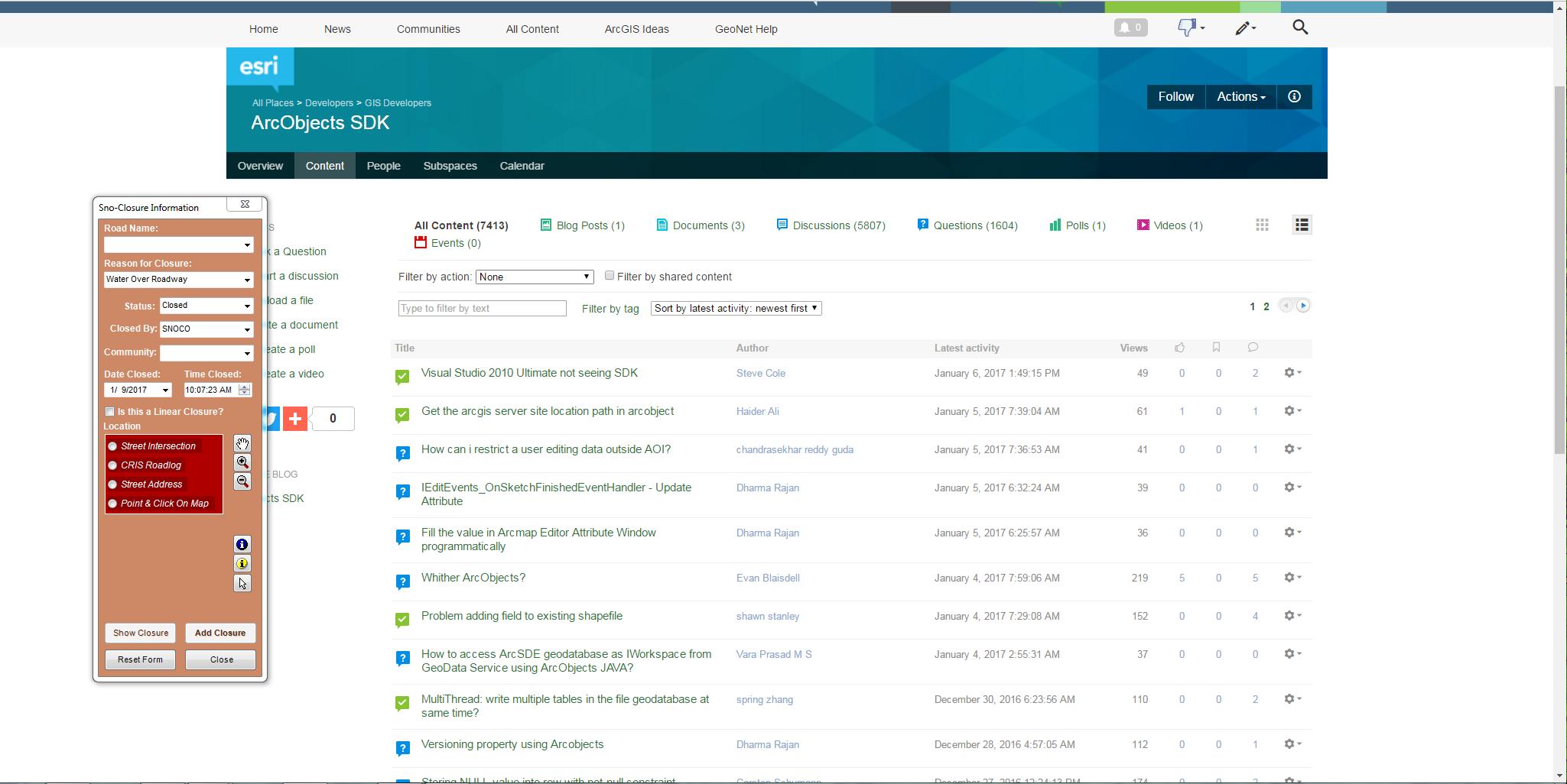

I'm sure this is a simple fix but I'm feeling dense and I've never figured it out. I have a .NET add-in that includes a Windows Form. For whatever reason, the Windows form will not minimize WITH Arcmap and stays "on top" of any application. What setting do I set to have the Windows form stay on top of Arcmap UI items but still minimize with Arcmap?
Here's my form on top of my browser while Arcmap is minimized.
Thanks!
Steve

What is your code that shows the form? Do you set the owner property?
SteveCole
Honored Contributor
The form is opened via a command button on a toolbar:

I found the TopMost property that was previously mentioned and, once I changed the property from TRUE to FALSE and tried to rebuild my project, I got a series of errors which I now can't get rid of:
The blue highlighted line is an example of one of the lines throwing the new error. It's all related, I'm sure, but I'm not understanding it..
SteveCole
Honored Contributor
The suggestion by Duncan Hornby‌ was the correct answer. Although the link from the old forum was bad, I think I found a thread that did make it over into GeoNet that had the correct solution. TopMost property did not solve the issue; rather, it was adding a little bit of code to the form's show method:
theForm.Show(System.Windows.Forms.Control.FromHandle(My.ArcMap.Application.hWnd))
In my last post, I mentioned that playing with the TopMost property introduced a series of new errors into my project. That was a weird one but I finally figured out a way to correct it. On my user form, I use rectangleShapes to indicate to the user when they have successfully completed input steps in their workflow (when they complete a step, the shading behind that input turns green). RectangleShapes are part of Microsoft's Powerpack controls and, for whatever reason, the rectangleShape is a "private" control whereas every other form control used is public. I was trying to update the properties of the rectangleShape from the code from outside the scope of the form's codebase so that wasn't allowed. To work around this, I added several public properties to my form which allow me to do what I need to do:
