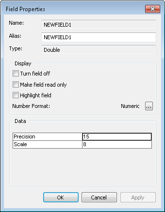

I have a VB.NET set of tools and part of it which used to work does not seem to work any more as it used to.  The part of the script which is not working properly anymore is when adding a field to an existing shapefile.  Although I am setting the precision and scale properties of the ifieldedit interface the resultant field displays in ArcMap as having precision and scale values of 0.  The type of the field is esriFieldTypeDouble.

Thanks for the link, although my reading of it is that it can support precision and scale.  This also supports my recollection that my script used to add the field with precision and scale values in the past.
Although we don't have earlier versions of ArcGIS installed here at work we do have ArcView 3.3 still working.  So I tested in that the addition of a field with precision and scale values to a shapefile.  The shapefile when opened in ArcGIS 10.4.1 reports the precision and scale correctly.
When I tried to add a new field directly through the table interface in ArcMap it did not create the field with precision and scale values.
