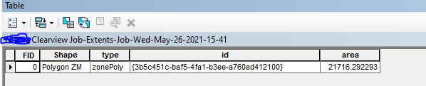

Hello, I am fairly new to programming for ArcMap, and need some help. I am currently making an add-in for a weed sprayer, and need to access the attribute table for selected jobs to read the area. My add-in launches inside ArcMap, but I can't figure how to actually access the data inside ArcMap. Any help with this would be greatly appreciated. Thanks.
