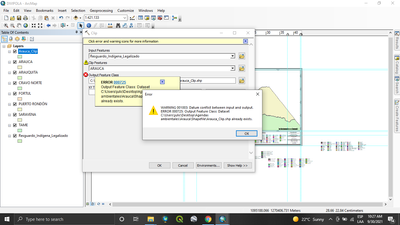

Hello everyone,
I am trying to generate new clips Layers, but I keep receiving 'WARNING 000725' that states the data set I am creating already exist and what I make now will overwrite it. However, I do not have an existing data set anywhere and all I generate is stored in new geo-databases that lack these ostensibly preexisting data sets. I've never made these layers before, and I receive this warning every time I clip, reclassify, or create anything.
Why do I keep getting this message?
Thank you,
Juliana

Hi @JulianaChaparro ,
this should help with the datum error:001003: Datum conflict between input and output.—ArcGIS Pro | Documentation Usually this comes about when the Coordinates do not match.
There may be 2 workarounds for your first is you can change the name of the output feature classes, or you can have a look in here : ArcGIS Help 10.1
let me know how you go
