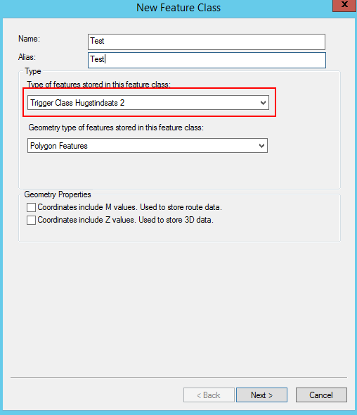

I have an issue with registering feature classes. We have created a Feature Class and registered the DLL through “ESRIRegAsm.exe”, and it appears in ArcCatalog:
But when I try to create the Feature Class, I get the following error:
Which isn't very helpful, unfortunately.
