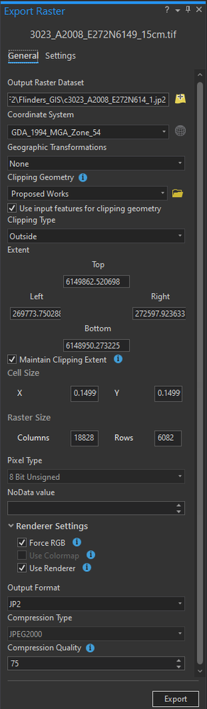

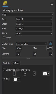

Hello @Richard_Nairn I like to trial this in interactive form first. I can get this to work with output to JP2's with the following
  1. Export the image initially as TIFF.
  2. Load the TIFF image your interested in.
  3. Go to the symbology tab and Set the Mask values to (0,0,0)
  1. Create a new area feature class and draw a polygon which has the image extent
  2. Right click the TIFF image in the table of contents and select Export Raster
    1. Set the output name to be <name>.jp2
    2. Select the clipping Geometry
    3. Clipping Type : Outside
    4. Use Renderer
    5. Force RGB
    6. Output format JP2
    7. Compression Quality 75
Output image is a 4 Band JP2 image with Alpha band
Hope this helps. some
Gordon

@Richard_Nairn there is a really good dicusion here on the merits of the Export Raster tool v's the Copy Raster tool. They key is the Force RGB option
" Check the Force RGB check box to export the output raster as a three-band RGB raster dataset with the current renderer. Additionally, while exporting to formats such as TIFF, JP2, PNG, and MRF that support alpha bands, you can use this option to export the data as a four-band raster dataset with an alpha band to preserve the transparency settings of the original data"
It appears the copy raster tool does not have this capability but has the Ignore Background Value option which may be the same.
Hope this helps
