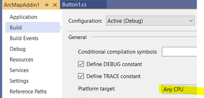

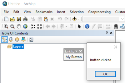

KirkKuykendall1
My SDK got installed here, in its default location: C:\Program Files (x86)\ArcGIS\DeveloperKit10.8
Attached project was built by File>New Project, choose choose "ArcMap addin", and chose a button in the wizard.
It's compiled for "AnyCPU"

Hi,
Thanks for sharing your setup! I re-installed the ArcObject sdk and it worked. I think somehow I mixed the installation process and caused the problem.
