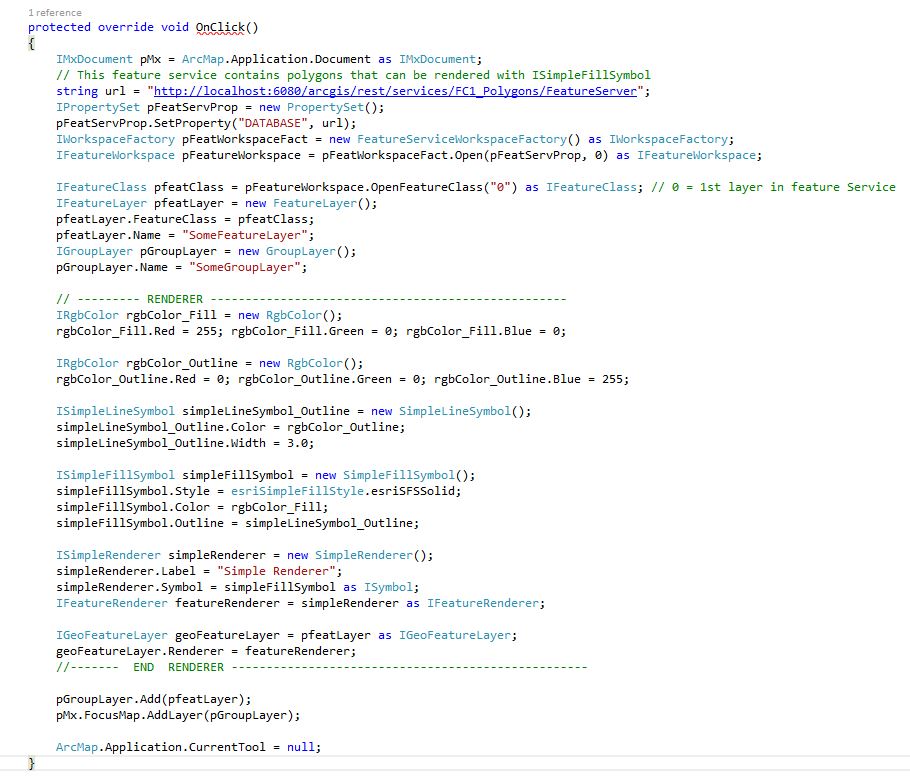

The code sample here below shows how to add a feature service to ArcMap using ArcObjects (click on the image below to enlarge the image):
How to Add a Feature Service to ArcMap

Thank you, very much, but in your example you create your own new layer.
Isn't it possible to get the layer with it's symbology/renderer from the Feature-Service?
seria
by Esri Contributor
Mickey,
Yes, that is correct. I do create my own new layer to add to ArcMap. One would definitely need an instance of a new layer object to hold the properties of the incoming feature service data, so there is definitely a need to create that new layer.
However, in order to symbolize and display that new layer the exact same way it was being displayed on the server (and I believe this is your question), you would simply not assign a renderer to it. Thus, in the code I provided earlier, all you'd have to do is  to comment out the "renderer" part of the code. This should allow the display of the layer in its "original" form. In this case, the original renderer that was used for the feature service layer on the server (the REST endpoint) would automatically be utilized by ArcMap to render the layer.
