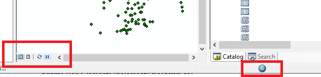

There are scenarios where a map is slow to load, and so we want to pause the map from drawing, so that we can turn a slow layer off, etc..
Often, we can just click the pause button at the bottom of the map pane:
But sometimes, the mouse pointer isn't available for clicking buttons. When we hover over the pause button, we get the Windows loading icon/pointer:
Question:
Is there a way to pause pause the map when that happens?

I think the answer might be to just left-click the globe-loading icon:
That seems to pause the map, even when the mouse pointer isn't available when hovering over the pause button.
