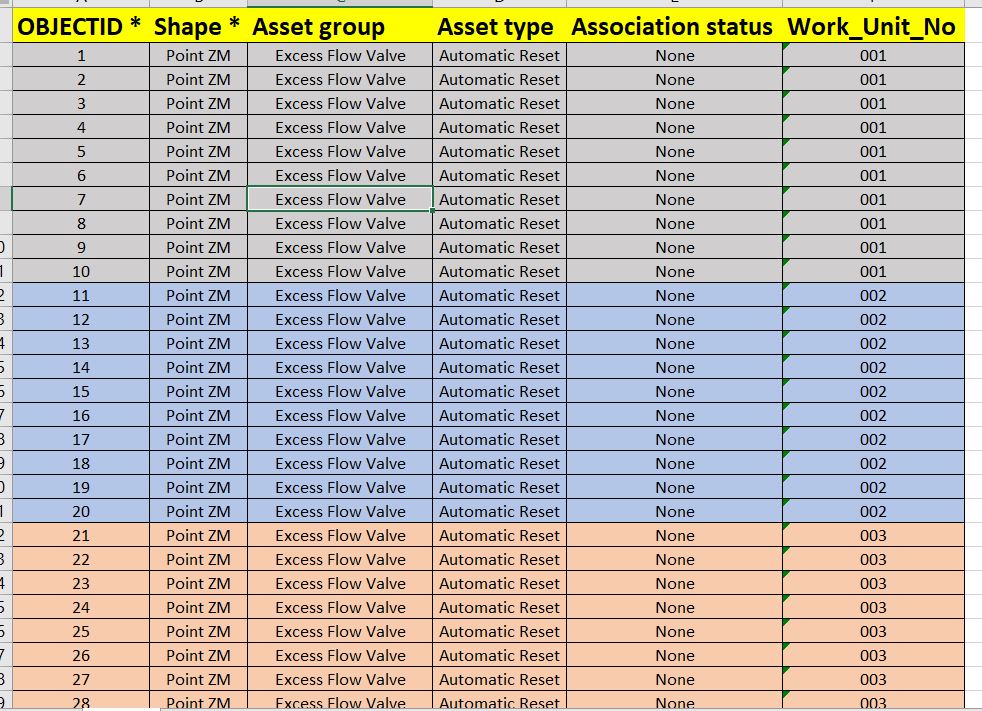

Hi Friends,
kindly attached .gdb, example excel sheet, and image for your reference. I want to create a unique id 001 for each batch have 30 point feature, next 30 point feature I want to create 002....etc like that
I want to create at a time any arcpy code available please help me.
I want to create a unique at a time like 001,002,003....etc each batch has 30 point features see the example below.
Thanks
Santhosh

santhoshp
Hi KimGarbade,
Can you share with me the above code? Exactly I am looking at the above result.
Thanks
Santhosh

santhoshp
Hi KimGarbade,
when I was using the above code it's showing the error message. can you see the below image for your reference
Thanks
Santhosh

santhoshp
Hi KimGarbade,
Finally, I got the Result of my data Thank you so much for your help.
Thanks
Santhosh
Result in my data below
