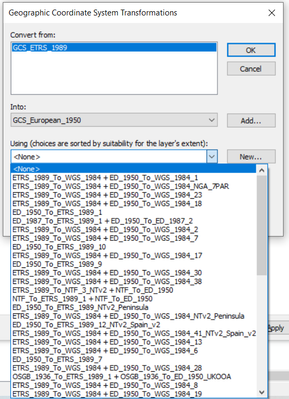

I need to make a Geographic Coordinate System Transformation from "GSS_International_1924" to "GCS_ETRS_1989" but my ArcMap (Version 10.4) doesn't have any method for that.
Can somebody help me?

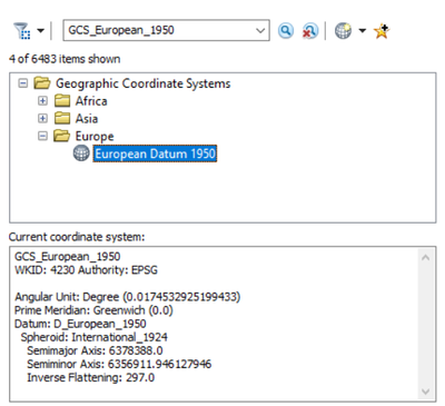

"International_1924" is a spheroid, not a datum.
You should try "GCS_European_1950".
