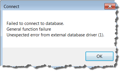

I recently upgraded to 10.5.1 from 10.3.1 and have noticed that I can no longer drag and drop an XLS table into ArcMap 10.5.1 like I was able to do in 10.3.1.  I get a "Failed to connect..." message, as illustrated below.  But I can drag and drop an XLSX, but I have to open the XLS in Excel first and save it as an XLSX...a bit inconvenient.
Is that a bug, or do I have a dodgy install of 10.5.1, or do I need to make a setting somewhere to be able to drag and drop and XLS, or is that just the way it is?
Thanks.
This message is produced when I drag and drop an XLS table in ArcMap 10.5.1.

from recent reports.... get used to it... search this site using the error and you will find some threads indicating there was a non-fix, then...
https://community.esri.com/message/722098-unexpected-error-from-the-external-database-driver-1

Try using the excel to table tool drag and drop is a convenience, but not an optimal approach... also
Excel To Table supports Excel Workbooks (.xlsx) and Microsoft Excel 5.0/95 Workbook (.xls) formats as input.

Forgot about the Oct 17 Windows update.
Hot of the press.....
http://support.esri.com/en/technical-article/000016969
CarlBeyerhelm1
OK.  Thank you for the follow-up.
I did apply the 2007 Office System driver as per the technical article cited in your link above.  In my case, however, it did not have the desired effect.  Nevertheless, I appreciate the info.

The fix mentioned in this article corrected the problem for me. I can now read XLS files in ArcMap/Cat
