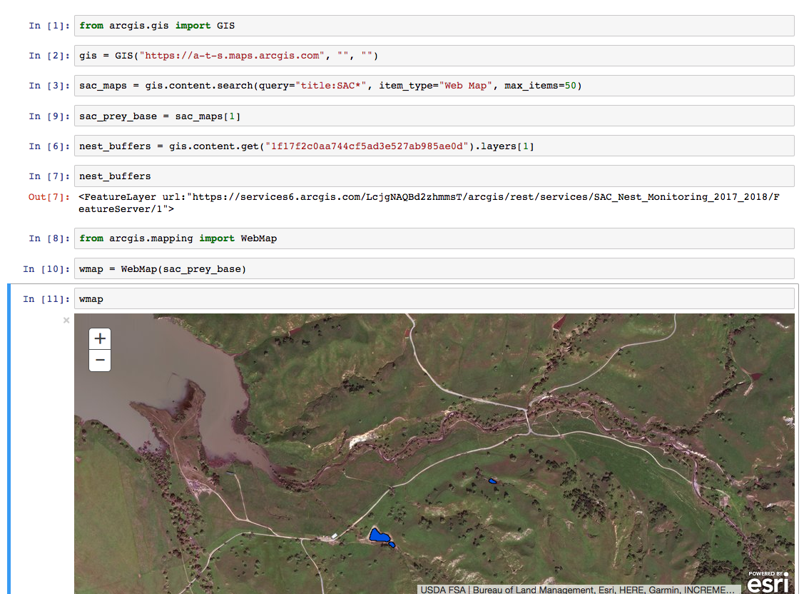

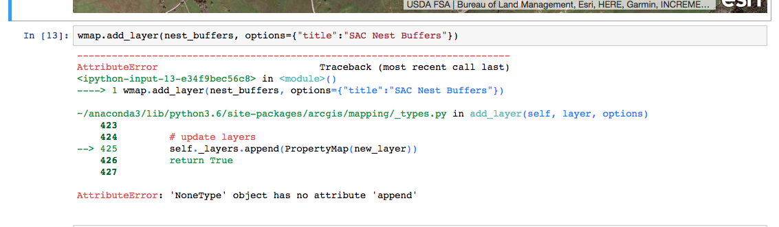

I am trying to add a feature layer to a Web Map, and when running the ".add_layer()" method I am getting an error. The error is an AttributeError: 'NoneType' object has no attribute 'append'. Eventually, I would like to be able to run a loop and add the layer to a selection of web maps.
The two photos below show the Jupyter notebook of the steps I took. On a couple occasions, I ran the ".update()" method after the error with the .add_layer and the feature layer was still applied to the map, but this didn't always work.

NoneType means that 'None' was returned by a step.  But then you say that 'update' was used and it worked?  If that is the case, then whatever you did to remove the lack of something being returned is good

Thanks for the response! When I try the '.update()' method I get the same issue with the NoneType object. When I called the 'wmap' again to see why it was coming up as a NoneType, a popup dialog box asking me to log in with my credentials appeared (I have attached a photo below). I am wondering if this is why I am getting the NoneType error?
Additionally, I noticed that when I pass '.update(item_description={})' (without signing in) the method returns True and the layer I wanted to add was successfully added. When I tried looping through multiple maps to add the layer to each map, while passing 'item_description{}' in the update method, the maps didn't update and I received the NoneType error again. If there is a way to stay signed in while calling the '.add_layer' and '.update' methods I believe this will solve my problem

I'm not to sure on this one, but it appears that there is an issue with how the layer authentication is working.
If you input your username and password, are you able to run the tool?
If the layer is shared with everyone, Are you able to run the tool?

The tool seems to work seems to work whether I input my username and password or not. The layer should be shared with everyone. I will contact technical support for further assistance.
