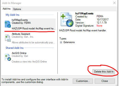

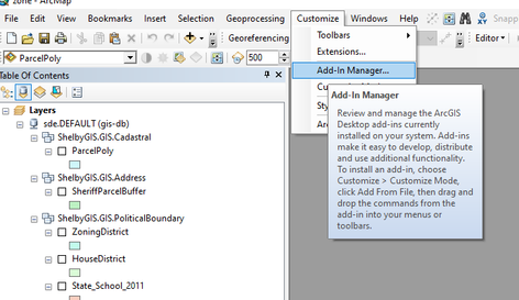

Hi @CathyLWalker
I'm not sure if you've already figured this out, but to remove a custom add-in follow the steps below:
1. Open the Customize tab above your toolbars and navigate to "Add-in Manager"
2. On the Add-In Manager page, select the Add-In you would like to remove and select "Delete this Add-In" on the bottom right of the open window.
