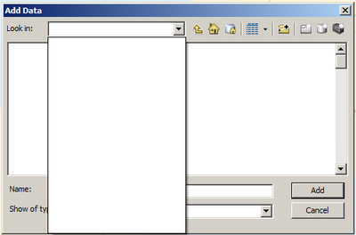

I am using ArcGIS 10.7.1  and when I go to add Data the Dialog box is blank.  I can open Catalog and see the linked data sources.  I can even get to Catalog from the Icon on the top of the Add Data dialog box.
I should also mention I can drag a layer from its source and drop it on the map, but the Add Data dialog is always blank from where ever I access it.

Try resetting the application.  First close all maps and catalogs. Go to here C:\Users\{username}\AppData\Roaming and rename the Esri folder to Esri_old.  Now restart the map and see if its fixed.

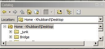

In Arc Catalog all my old data connections are there.

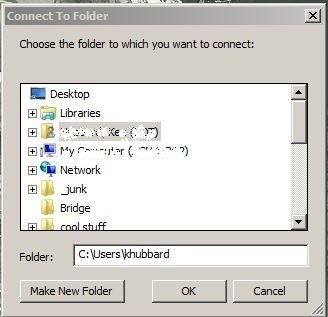

 I've tried it, I can use the folder icon to get to the catalog connections, navigate to a new folder, but once selected the dialog remains blank.
