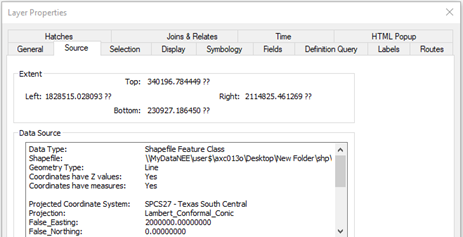

In ArcMap, noticed unknown units in both layer properties, and bottom-right of ArcMap (show screenshots)
Notice the question marks, denoting unknown units.
 This is the display at the bottom-right of ArcMap.
