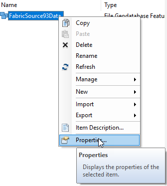

TimHodson
Hello Jeff, sorry for the delay. A good place to get answers to parcel fabric questions is on the Land Records group: Land Records
For your question:

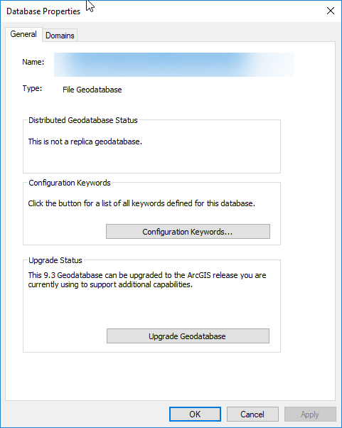

1. you could start by looking at the properties of your geodatabase, and look at the Upgrade Status. If it can be upgraded you will see the Upgrade Geodatabase button on the properties page:
2.a) Next open the feature dataset's properties:

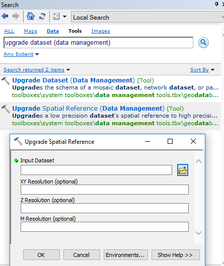

b) check to see if the Geometry properties have Storage as High Precision:
If the precision is not set as High, then you will need to run the Upgrade Spatial Reference GP Tool:
