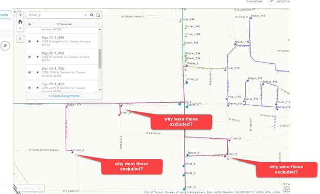

My dispatcher map has 4000 signs grouped into 160 routes with 24 signs linked to a route.  When I preform a search on a route-id, the map only returns 12 of the 24 signs.  The same query works fine in the Map Layer Filter and all other queries.  In the example below I am search on "Driver_6".  You can clearly see many (12) features that are labeled, "Driver_6", where not included in the results (they don't have the blue box). This happens for all routes.  Where can this be controlled/set?  Is there a 12 record return limit on "Locate" results?

Email discussion with Jonathan - this is a known limit with Workforce that forced us to limit the features returned to 12. We are looking at improving this in an upcoming release during 2020.
