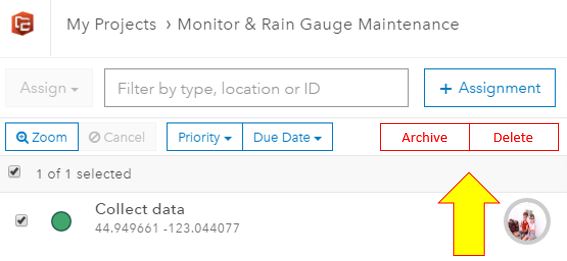

This is my first time trying to use Workforce. So far so good other than I can't figure out what I'm supposed to do with all the completed tasks. As a dispatcher, I don't want to see thousands of completed tasks and I can't find an option to delete or archive it after it's been completed. We are using Workforce in tandem with Collector so once related records have been added in Collector, there's no need for the Assignment.
I'm looking for something like this in Workforce:
Archive/delete feature using Workforce
I figure I could probably delete the Assignment feature in the web map but it seems clunky to have to do this and the dispatchers who will be using this map won't have the skills or patience for this. Hopefully I'm missing something simple here....

Caleb, thanks for trying out Workforce and for asking this question.
You're not missing anything, there is no way in the app to Archive or Delete assignments.  From our user discussions, it was clear that Dispatchers should not be able to delete assignments, even if they've been completed.  The ability to Archive assignments is something we considered, but since there are many ways people want to archive assignments, we went with a different approach.
We've written several scripts in our github repo: GitHub - Esri/workforce-scripts: A set of scripts to help administer Workforce projects. These demonstrate how to delete and/or copy assignments to another feature service.  These scripts can be set-up to run against the workforce project and can clear out any assignments that satisfy the query.
We feel that this script and the flexibility it provides is a better alternative to providing an in-app experience for removing assignments.
