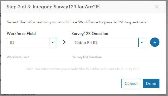

AnthonyRyanEQL
Wim,
There is way to connect them together. When you're setting up the survey, you have to add another field that is hidden to pass the ID of the workforce record over. When you are in Workforce configuration for Survey123 integration, after selecting the survey you select the field you wish pass over
