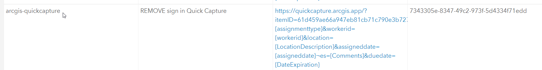

Hi, I am using Workforce and Quick Capture together. Quick Capture hasn't been added in yet as an integration in the Workforce web version yet, so I've added it in manually in the Assignments Integrations table manually through ArcPro. I have also added in new fields.
I'm not able to create a managed offline area in web or download an offline area on mobile. Is anyone able to advise on this? When the managed offline area in web fails, is there a log file or place I can look to pinpoint the problem?
