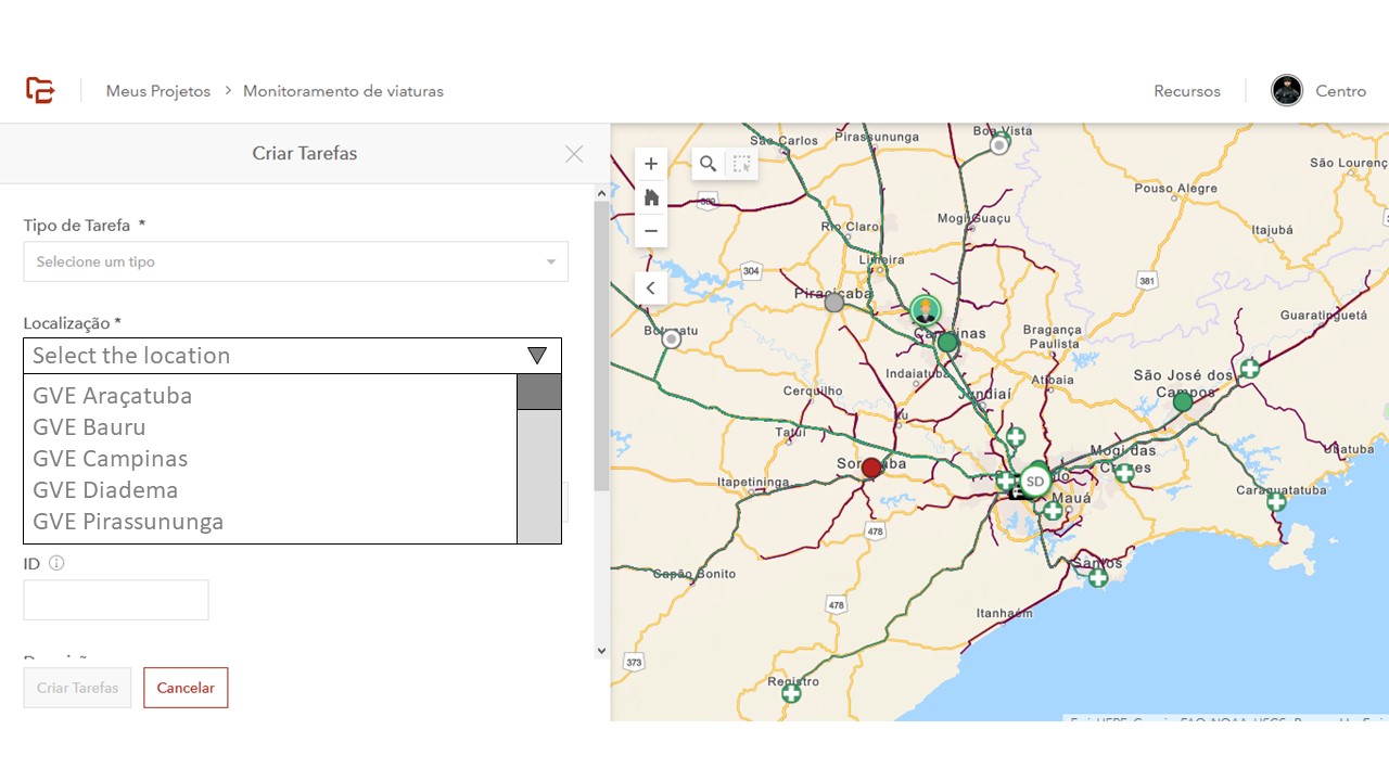

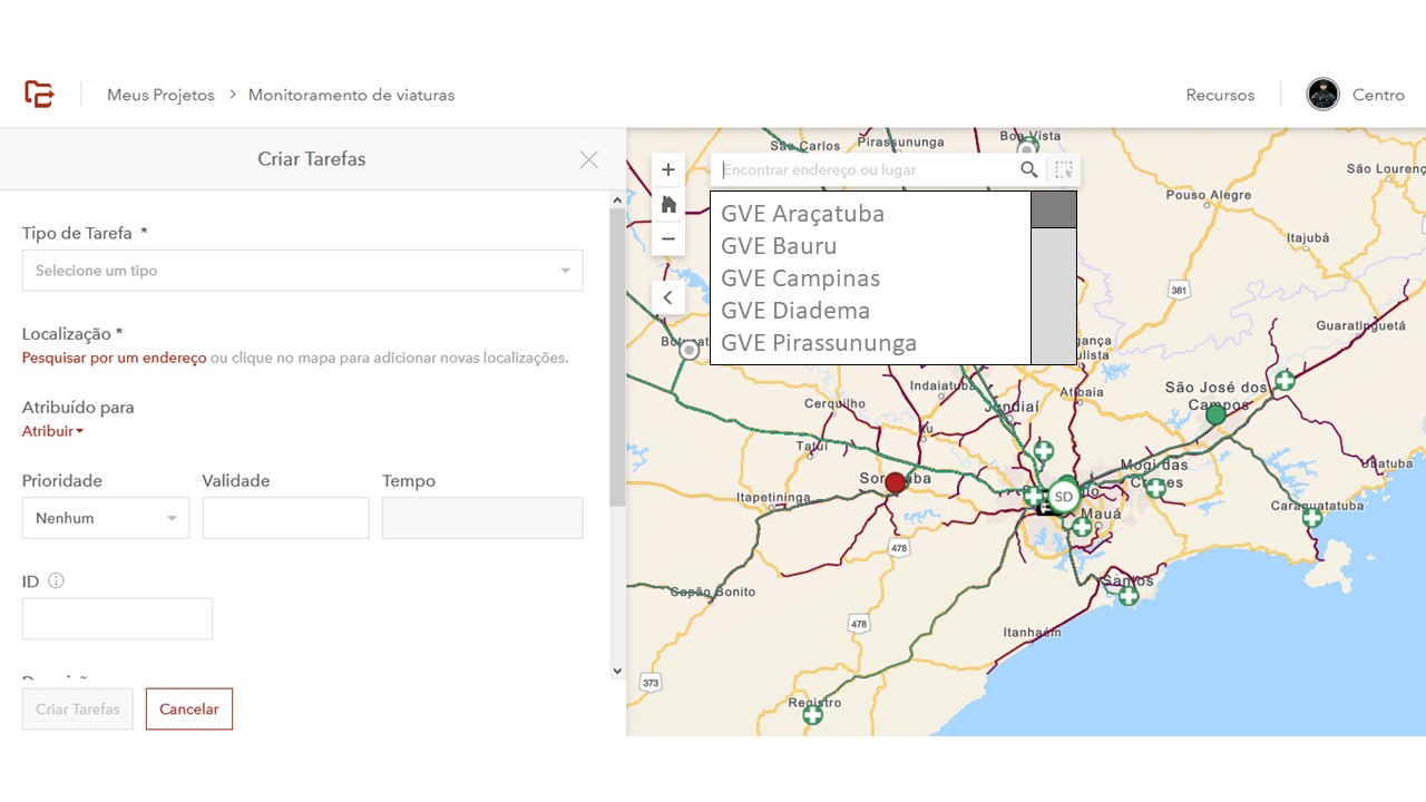

Hi all,
Is there a way to customize or somehow configure the 'Create an Assignment' page, the field Localization?
We currently have a manual process to find some places in the map.
After finding the location, we must click on it and create the task in Workforce.
My client has a list, with 200 places, which are in a feature layer, which is on the map for assigning tasks.
Instead of searching the map, he would like to click on a list on the creation page, standardizing the destinations of the tasks.
How can I create this customization?
Thanks,
Diego
Idea 1
Idea 2
Atenciosamente,
Diego
CraigGillgrass
Hello,
It's not possible to customize the Create Assignments dialog to provide this ability.
However, I believe you can achieve this by using the pop-up title for the feature.  When an assignment is created from an existing, the pop-up title is used to set the Location string for the assignment.  So, if you configure the pop-up title for the features with this set of standard locations, I believe you can get the behavior you're requesting.
