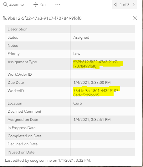

Hello,
I just migrated my old Workforce projects from Classic to the new release. I am trying to create a dashboard for upper management using the Dispatcher Map from the workforce project. However, I noticed that the pop-ups for the assignment layer show the globalID for the assignment type and workerID rather than a more user friendly text which I found is hidden in separate tables.
I am thinking I might need to use Arcade to create custom pop-ups to pull the information I need from the related tables using one of the FeatureSet functions, but not sure where to start, and don't have a lot of time to fix this problem. Here is a screenshot of the fields that are currently gobbledygook and need to be more user friendly.
Any help would be appreciated. Thank you!

If you're comfortable using Python, we have a script that can generate a joined view that is ideal to use in dashboards since it will allow more filtering and visualization options.
https://github.com/Esri/workforce-scripts/blob/master/readmes/create_joined_view.md

WillArellano
Thank you, I will see if I can figure out how to use what you provided. I am just starting to learn Python, and not sure how to use it in AGOL.
WillArellano
I figured out how to run the script, and once I figured out the syntax for passing the arguments to it, everything worked perfectly! Thank you!
ahagopian_coj
Is there any way to do this using Arcade?  I am using the Screening Report widget to generate a customer report and need to add assignment type as the description not the globalid that shows in Assignments.
