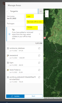

Are there going to be adverse effects if I add in three more fields the Assignments layer? I read in the documentation somewhere deleting layers or changing field names will cause syncing errors. I wasn't sure if this was true for adding in new fields as well.

Does it make a difference which option I pick for deleting/recreating the area or pressing update or does it need to be a full delete map area?
You should re-create the offline area, this will delete it and create a new one.

Generally, this should be okay. The recommended approach would be to delete any offline areas in the mobile app and any pre-planned offline areas. Then add the new fields to your layers. Then create new offline areas. If you don't create new offline areas, the mobile workers won't have access to the new fields.
elpinguino
Hi @Anonymous User , Thanks for your reply. Does it make a difference which option I pick for deleting/recreating the area or pressing update or does it need to be a full delete map area?

I've added in the new fields, removed the offline map and recreated it. I can see it on the mobile app, click on the project and see the offline area. I click on the map area where there are a few points. A window comes up for me to choose which point I want to get more info on. I then click in that window on the point I want more details about and the app crashes.
