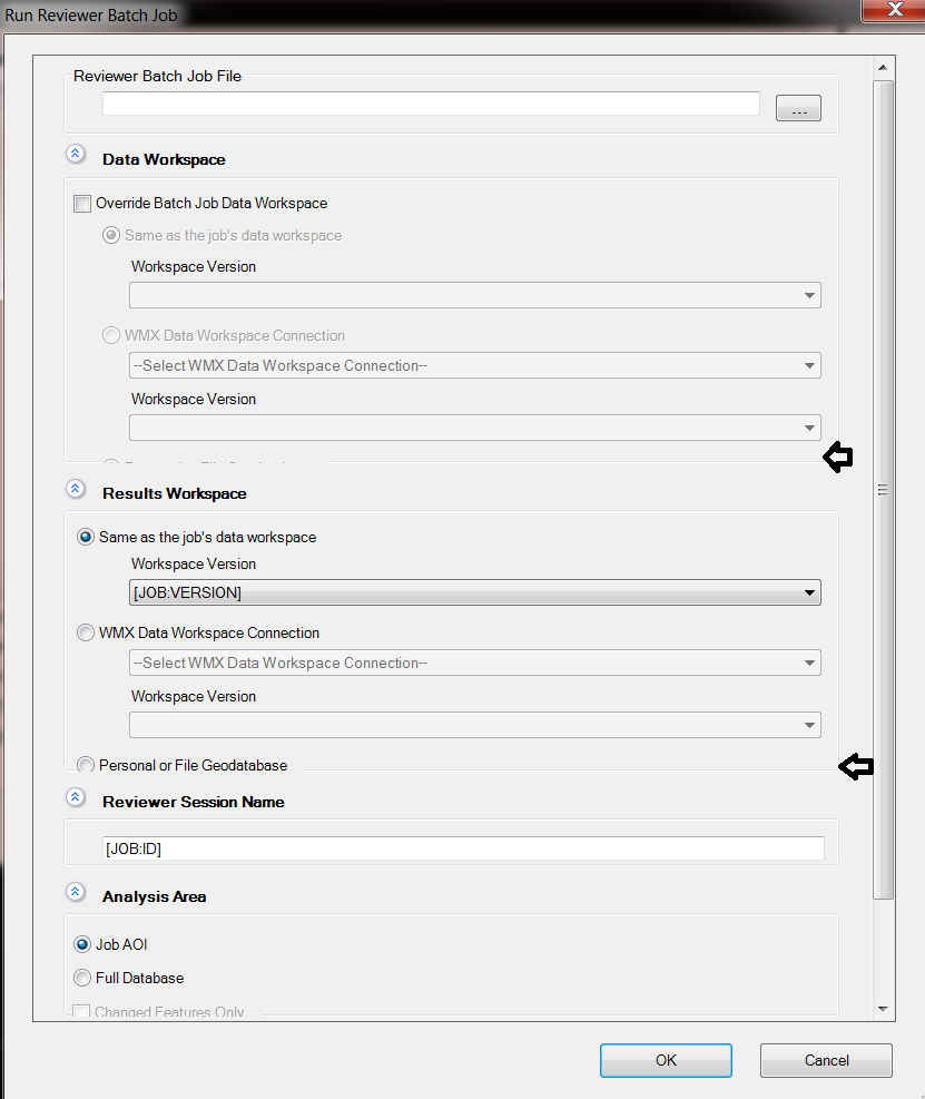

Hello,
I am interested in integrating Data Reviewer with Workflow Manager. The 10.4 release allows users to open a reviewer session and integrate batch jobs. We use personal gdbs to keep track of the reviewer sessions, but I am open to having it in one gdb.
My questions are:
1) If I used WMX Data Workspace connection would it create a large number of tables to my Workflow database
2) Would any technician be able to see their past sessions and be able to see other technicians results
3) Are there permissions to revoke batch job privilege's?
4) I also noticed the customize button for the batch reviewer is not letting me select a personal gdb. The text gets cut off.
Amanda De Medeiros
Esri Canada
AmandaDeMedeiros
So I figured out why the box for the tool is cutting off the Personal gdb selection. ArcGIS and other similar software that increased DPI's cause overflow,  I re-set the Screen resolution to 100%
