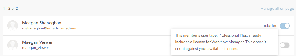

But when I click "Manage", I see a message that the user type professional plus already includes a license for Workflow Manager:

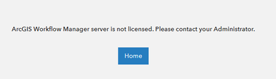

When I attempt to access the workflow manager web application, I see an error message that workflow manager is not licensed:

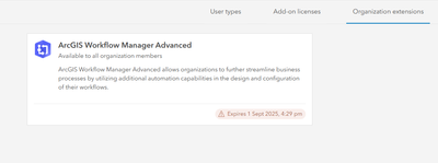

Hey @mshanaghan when looking at your licenses, do you see the organization extension applied:
either standard or advanced?

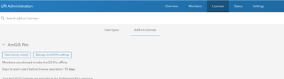

Thank you for your response. I do not have an "Organization extensions" tab
and I do not see Workflow Manager under the "User type extensions" section in the Add-on licenses tab.
Does this mean that Workflow Manager is not included in my organization's subscription?
