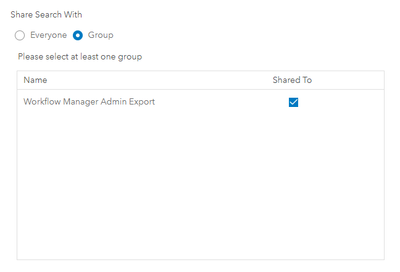

Not sure if you figured this out already but you'll need to share the different Shared Searches with groups to achieve your goal here. So, all users that would need to see All Jobs would need to be in Group A whereas all users that need to see My Group Jobs would need to be in Group B. Users could be in both or one or the other group.
