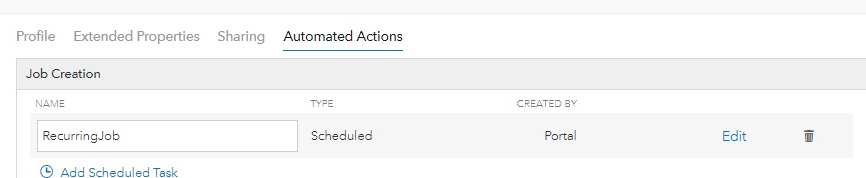

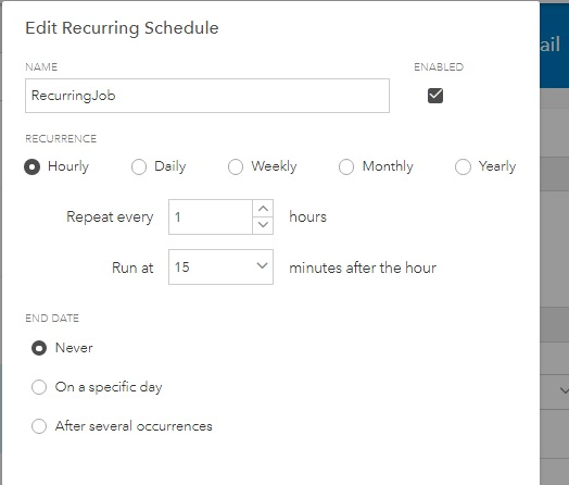

We are using ArcGIS Workflow Manager Server (service-driven). We have created simple workflow diagram to send Email and scheduled the same as "recurring Job" in template.
Job schedule is set to 1Hr 15min.

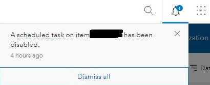

After 1Hr 15min, in portal appearing one notification.

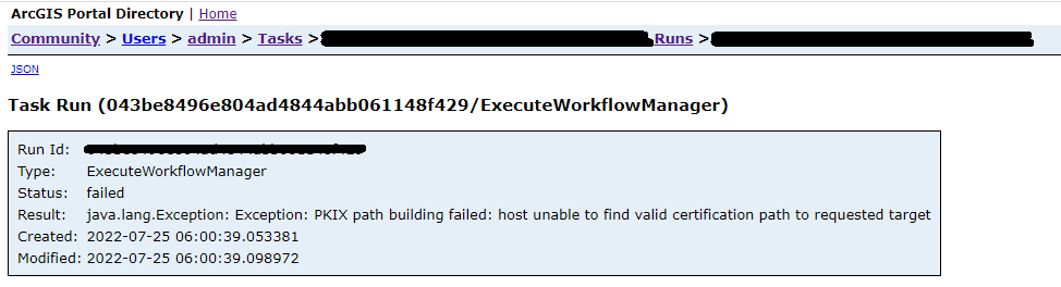

We have verified the "Tasks" under "ArcGIS portal directory" and the following exception it is showing.
java.lang.Exception: Exception: PKIX path building failed: host unable to find valid certification path to requested target

Hi @sirishb
Can you import your CA cert into Portal Admin? This is likely the cause.
https://enterprise.arcgis.com/en/portal/latest/administer/windows/import-a-certificate-into-the-port...
