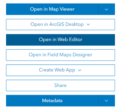

Also unfortunately ESRI only allows "Creator" user type and higher to use web-editor.
Here is what it should look like on one of your web-map items:
CraigGillgrass
yes, that is true @ClayDonaldsonSWCA@DennisKaplan3333333333 this may be what you are seeing.  The user must be a Creator named user to access Web Editor.
