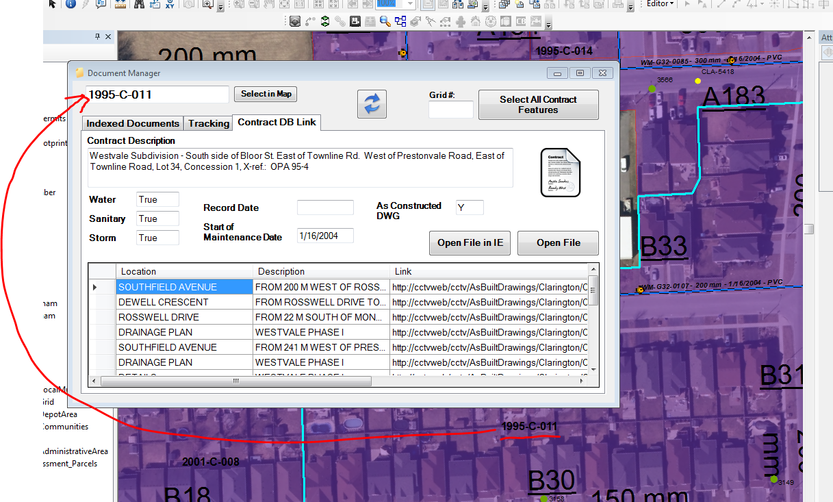

I'm a total beginner with WAB, but what I want to do is take a tool I have developed for ArcGIS Desktop and bring that into a web app.  How the tool works is:
1.  User selects a construction contract boundary from a polygon layer
2.  User clicks on the 'Document Manager' tool (in ArcGIS)
3.  A windows form opens up, connects to a web API which returns some JSON with the details on the contract boundary, based on the CONTRACT_NUMBER of the polygon.
4.  Information is displayed on the form.
See the screenshot below for an example.  All of the data here is returned via JSON.  How would I replicate this sort of behaviour with a Widget?  Where do I even start?  I realize in webapps there are no 'forms', but I guess some sort of panel to display the info would work??  I am not a web programmer at all, so just looking to get some ideas.
Thanks!
