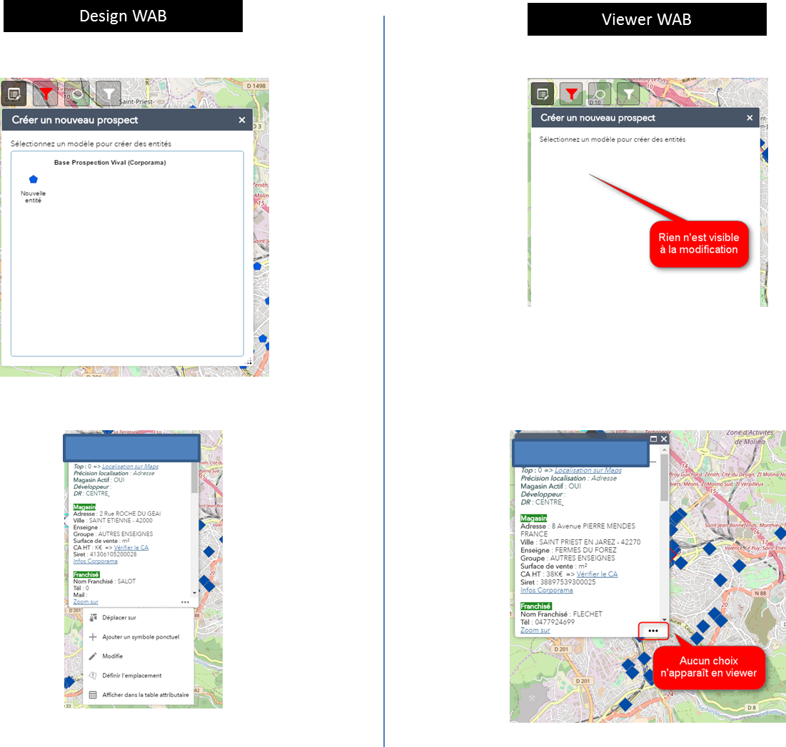

hi,
i've a problem with the widget edit since the new update of AGOL.
I've made a apps with Web App builder from AGOL many months ago (V1.1) that have the edit widget.
Since last update of AGOL, this edit widget does not function anymore in the wiever (but does function is the design)

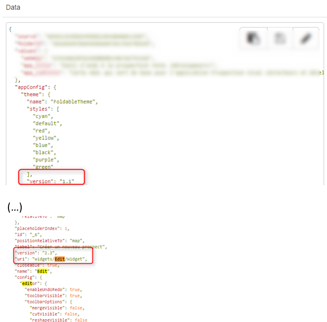

I think it is a pb of version of the app that does not support the new version of widget

Louis,
   I would definitely agree you can not use a 2.3 version of the widget in a 1.1 version of the app. You best bet is to recreate your app in 2.3. If all you did was configure the app and widgets then the level of effort is very minimal for re-creating. If you did actual code changes the because you were using WAB dev edition then re-creating may involve more work.
