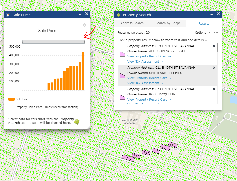

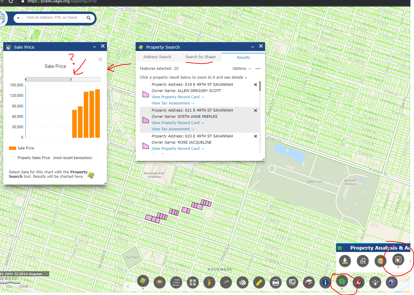

Why does Infographic not show all results (by default)?  I am using the current WAB 2.12.  I feed Robert's eSearch result to some Inofgraphic chart widgets to show things like Sale Price and Value for selected parcels.
By default it seems to have the sliders only show some of the columns. This will confuse users, I will have to create a text span note to tell them to expand them.  https://public.sagis.org/sagisorg2019/
Is this a bug? Support said they did not know why it would do this.
After expanding the sliders...

Kevin, the horizontal bar on the top is to slide through the graphic columns showing in the chart. For example, when the returned properties are more than 100, it would be difficult to see all the graphics condensed together without the slide bar. I think in this case though, you may remove the properties with sale value to zero (the blank area in the chart), making room for non-zero properties by sorting by the sale price option in the widget. Does it make sense?
