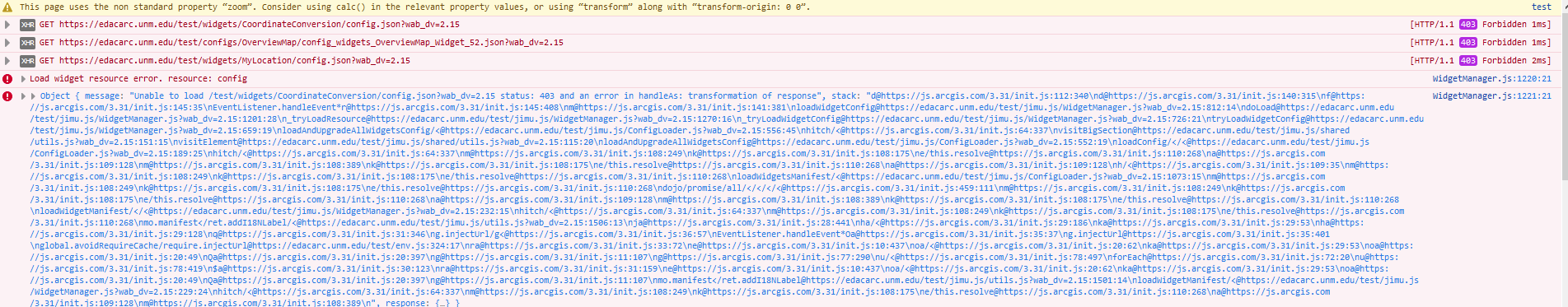

Thanks for the quick reply! I was hoping you would chime in, and fortunately (or not) you seem to be one of the lucky folks who isn't encountering the 403/CORS issues. We had a couple of font MIME issues, and the SVG was on my list to fix as well. We also saw the following, more troubling MIME warning in some cases:
The biggest frustration with all of this seems to be the inconsistency.
