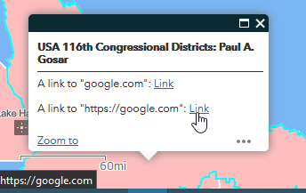

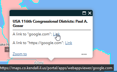

Here are two links. Note the address preview at the bottom of the browser.
Does this address your issue, or is it something else?

Ah, that simple. It's been a long day...
