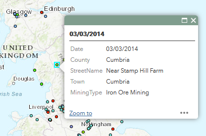

I have a web app on AGOL which uses one of the provided basemaps and a simple point vector layer. The pop up boxes on the app look great!:

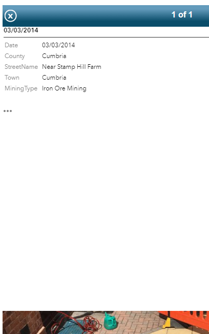

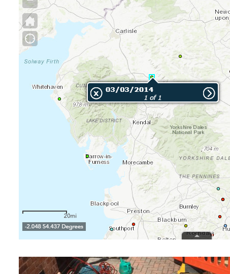

But when this map is embedded into our website, everything still looks great apart from the pop up boxes which change to some nasty 90s style box! what gives?
Clicking the > button on the pop up leads to the whole web app being taken up by the pop up box!:

Ah ok so all I had to do was add this to the end of my web map URL: &mobileBreakPoint=100
'100' being the amount of pixels the map width has to be before it switches to mobile mode with mobile pop ups. I believe the default is 600. So change it to whatever you want.
So my final embedded code is:
<style>.embed-container {position: relative; padding-bottom: 80%; height: 0; max-width: 100%;} .embed-container iframe, .embed-container object, .embed-container iframe{position: absolute; top: 0; left: 0; width: 100%; height: 100%;} small{position: absolute; z-index: 40; bottom: 0; margin-bottom: -15px;}</style><div class="embed-container"><iframe width="500" height="400" frameborder="0" scrolling="no" marginheight="0" marginwidth="0" title="Sinkhole_map" src="FULL URL OF MY WEB APP MAP&mobileBreakPoint=100"></iframe></div>
Now I'm getting the normal 'desktop' pop-ups on my embedded map.

Theo,
   The issue you are running into is that your embedded app is at the size where WAB switches to using the mobile popup. So to workaround this you can define the WAB mobileBreakpoints to force the use of the desktop popup instead.
