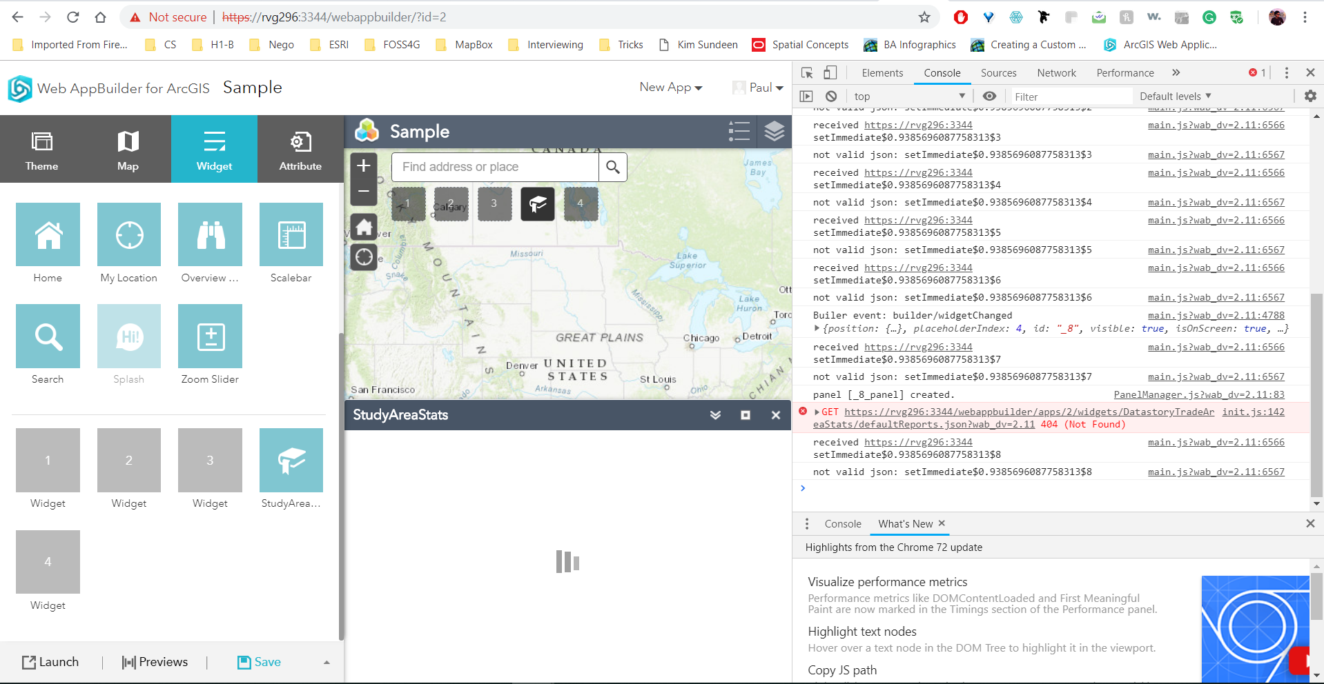

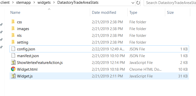

I am trying to build a custom widget using the Web App Builder Developer Edition. When I ran the batch file and imported the Demo widget at the position 4 in the off-panel widget and when I click it, it's not showing anything and keeps on loading. When I see in the console, it's showing a GET error with 404 (Not Found). Can anyone help me in fixing this? I am yet to host this application into our web server. I am currently running it on my local machine. Below are the screenshots of my chrome console and folder structure.

You have in your code somewhere a reference to a file "DatastoryTradeAreaStats/defaultReports.json" But you do not show that file in your image of your directory files.

But my code is providing a 404 Error not found which shows:
<!DOCTYPE html>
<html lang="en">
<head>
<meta charset="utf-8">
<title>Error</title>
</head>
<body>
<pre>Cannot GET /webappbuilder/apps/2/widgets/DatastoryTradeAreaStats/defaultReports.json</pre>
</body>
</html>
RobertScheitlin__GISP
MVP Emeritus
Rohit,
  Sorry this seems so obvious to me. You do not have the file defaultReports.json in your folder structure... So that is your issue. If you do not have this file anywhere or know what it is then how did it get added to your code?

  So does the defaultReports.json file exist in the apps widgets folder or did you only place it in the stemapps widget directory?
