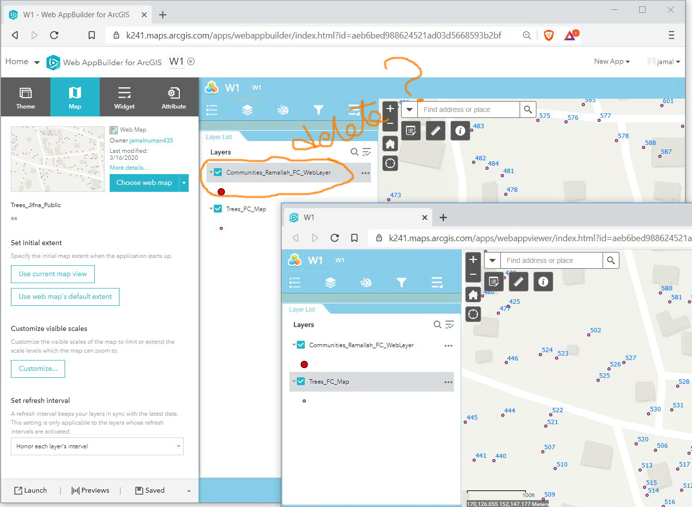

I couldn’t figure out to remove layers added to the App.

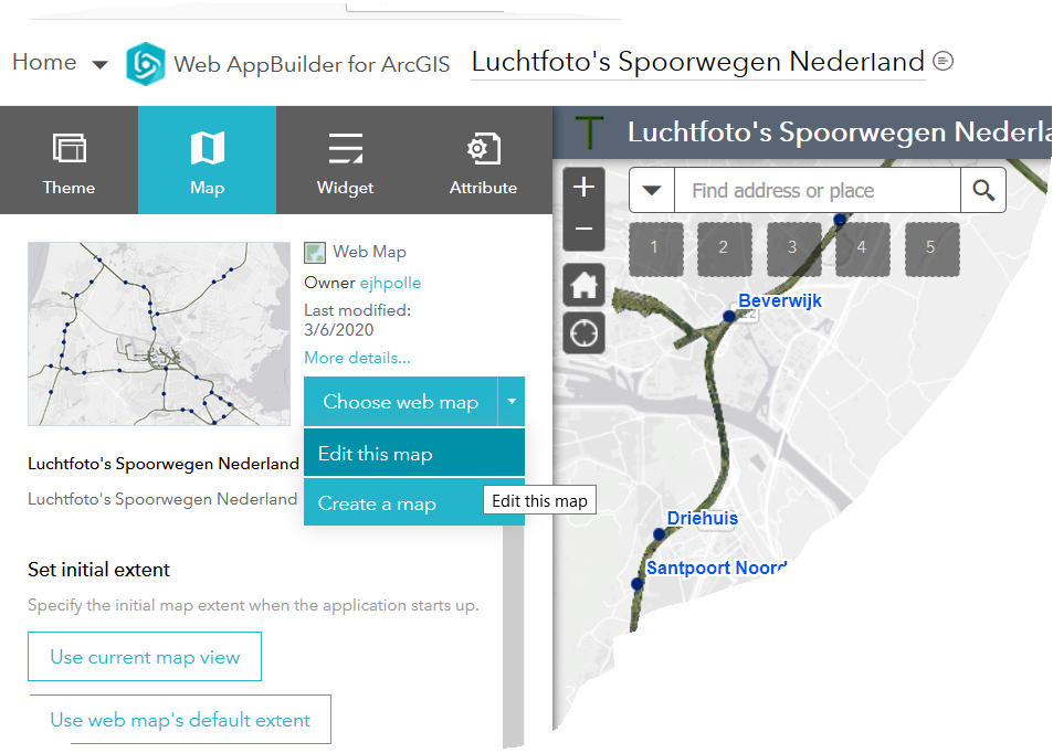

Two options:
  1. Edit your map in ArcGIS Online (or your Portal)
  2. Edit your map directly from within the Web AppBuilder for ArcGIS:
    • On the Map tab, choose Edit this map
    • A separate window will open, where you can actually edit the map directly - see the 2 screen captures below
