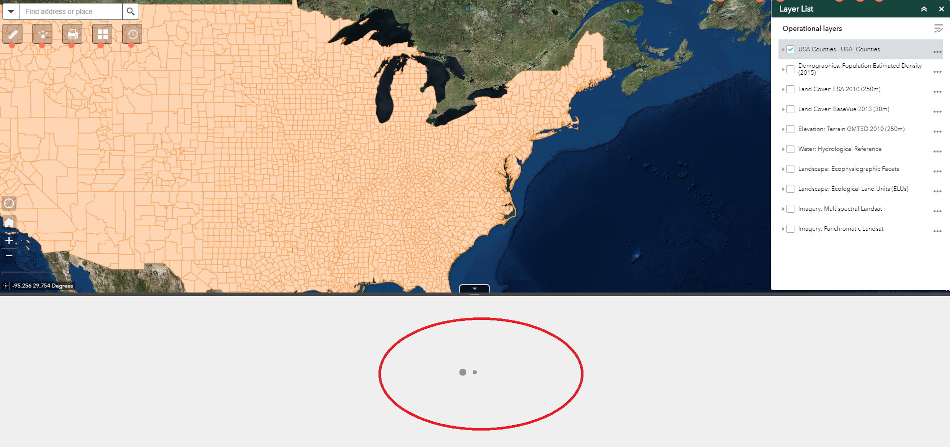

Hello everyone,
Recently, I have been having issues in my WAB-based web application when trying to view the attribute table of any layer in it, no matter whether that data is pulled from AGOL or from a local shapefile. Keep in mind that I am testing this with data where there is a small number of features in it. The attribute table (attached image) show a buffering/loading GIF and no table is pulled up. Do you have any idea what can be causing this? I checked my remote server and RAM is running at 40%, CPU < 10% so does not seem to be related to any overhead issue. Any help troubleshooting is much appreciated!

Correct the woff2 mime type is not the main issue the main issue is the failure to draw the graphics from the url that is listed in the error. Has the permission level for that feature changed lately? Can you go into the AT widget settings dialog and uncheck "Enable Filter by map extent by default" and test again?
FrancescoTonini2
Sure. That option was already unchecked (see image 1 below).
The specific resource was just pulled for example from LivingAtlas using the Add Data Widget...I just picked US countries to pick one. However, when I use the Add Data and pick a zipped shapefile from my local PC, and then click on View Attribute Table from the Layer List, it still buffers not loading and I do not get any errors in the console...(image 2).
