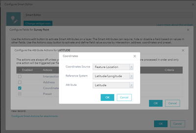

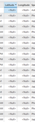

I have attribute actions set for two fields in my layer for latitude and longitude but it seems like the coordinates that get displayed in the Smart Editor widget are not actually getting saved to the table?

luckachi
Hi @AlixVezina - I just tested it myself and it worked fine. I have them set to not editable in the Smart Editor widget, just so the users cannot modify the coordinates.

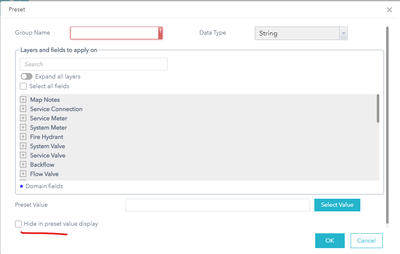

Perhaps you could have a preset attribute action set for the "Position Source Type" field and have it set to User defined or another value of your choice that would indicate this was created using the web app. Some users also add a new separate field for that purpose to their database to record that information in the same way.
luckachi
@AlixVezina it doesn't look like I can add presets to the individual fields, it seems to be greyed out, even when I enable editing and make the field visible.
Also, when I go through the main attribute actions tab, it looks like I can only add presets to visible fields? I don't particularly want to display ESRIGNSS fields.

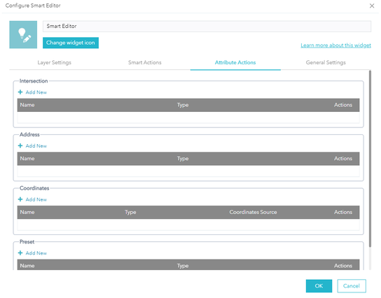

AlixVezina
@luckachi Please configure presets and other attribute actions from the Attribute Actions tab instead of the layer settings.
Fields need to be visible to be editable, this is how Smart Editor works right now... but you can at least hide the Preset from the main widget pane.
