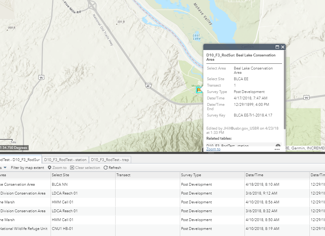

I've got a WAB app with attribute table widget configured. You can see in the pop-up that the value for the 'Transect' attribute shows up fine in the pop-up. But in the attribute table widget, the values don't appear. The values appear fine in the normal web map attribute table that the app uses, but for some reason they are not displaying in the WAB app. There are several attributes that show this behavior and the only similarity that I can find between them all is that they're all integers and they all have range domains. Has anyone else seen this behavior?
Update: I confirmed that the range domain is causing this. I removed the range domain from the 'problem' attributes and left them as ints. I then republished the feature service, recreated the web map, and WAB app. The values now display in the attribute table widget. Any ideas for a workaround? I don't feel like removing my range domains and allowing users to enter any int.
