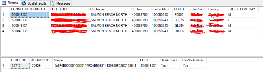

I'm trying (unsuccessfully) to use an Array in my for loop to return the unique route (along with other columns) that is in a related customer table.  See example below...
The top table is my customers table (i.e. related table), and the bottom table is my point feature class.  The related fields are "CO_ID = CONNECTION_OBJECT".

What happens is that I get the right ID and count of related records, but I keep getting the last record (in my customers table) repeating 4 times, with the same route "R003N".  What I am trying to get is something that looks like this for the popup...

HiDon Sjoboen ,
Quick question; is the field CONNECTION_OBJECT numeric or string? If it is numeric you should omit the quotes around the ID when you construct the SQL.
DonSjoboen
Hello Xander Bakker,
The field [CONNECTION_OBJECT] is an integer.
