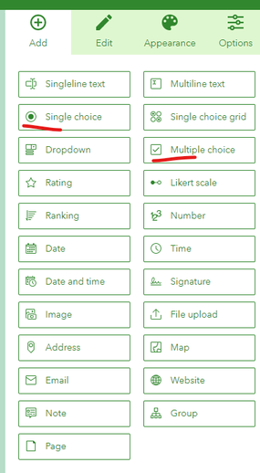

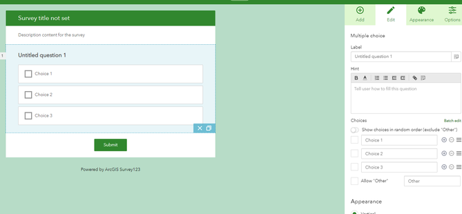

Otherwise, have you considered using Survey123 instead? The form will allow you to setup a question with options and checkboxes as you have described.
When you build your survey, you can add multiple choice questions add choices, and customize these choices. Once it's complete and you publish the survey, the feature layer will be generated from it with a schema already generated for you.
If you need to add choices later, you can edit the survey again and republish it.
There are also many other question options to support different data types and Boolean. You can also add some conditions based on previous answers.
