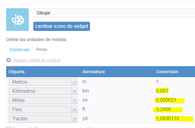

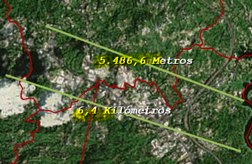

Hi,
I want to invert the separator for every thousand. When I use Draw widget in WAB I got a (,) separating the decimals and a dot separating the thousands

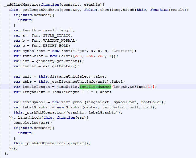

I identify in the widget.js file of the draw widget the variable that is used to make that separation and the symbols
So I opened the utils.js file and i found the pattern that is used to separate the thousands and decimals and it seems to be correct
I also check this in WAB widget option and it is using the same format and I would like to use a dot for decimals and coma for thousands
My question is, am i looking in the correct file to invert the symbols used to separate decimals and thousands?  How can I accomplish this?

Diego,
  The locale that your app is using defines the way the number will be formatted using the num.toLocaleString().
You can use the locale option to force the US english number format like this.
var localeLength = jimuUtils.localizeNumber(length.toFixed(1),{locale:"en-US"});
