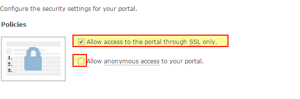

Matthew can change the setting so that Anonymous is not allowed as seen here under My organization >> Edit Settings >> Security...
The above will work for Matthew

I think you guys are right IF I was doing this in a web app builder that I installed on my desktop and use the "node.js" environment to create it.  But in this case, this app is created using the built-in version of app-builder in the portal.  See screen shot below:
I am going to try using the desktop version of web app builder, but I still need to get this to work, because I don't want to have to build all the little apps, and this is a non techie person who is doing this particular app.  The process worked easy enough for him to make the  map and app he needs, without getting down in the weeds.
I will continue to attempt finding these files/settings on the GIS Server, but I have not yet been successful.
