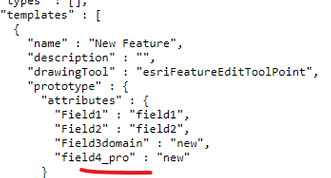

I think what's happening is that the feature template attribute is missing in your service's JSON and so the values are not coming through, and same issue with the presets. This is a known bug right now.
A workaround for this is to update the feature's edit templates in the web map - which should add the template back into the JSON and resolve the issues.

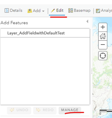

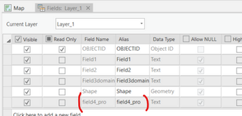

For example here is a sample layer where my new field added through Pro is missing in the template attributes (see on the right):
In your web map you will need to manage the feature templates for that layer.
And then just click "SAVE CHANGES" at the bottom (even if you haven't made any changes in the map). The template will be written into the JSON and the values (defaults and presets) will come through in Smart Editor.
