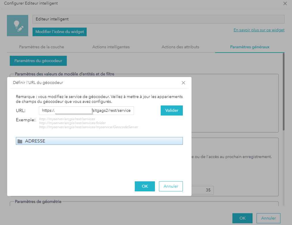

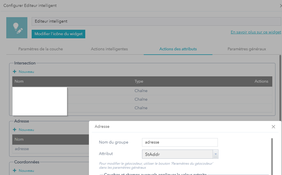

Hi there! Im using a webApp with smart editor tool.
I'm trying  to configure the widget so that when I add a point, the address is automatically filled in my layer's address field.
Unfortunately this does not work.
here is some picture:
1. My geocoder is define in ArcGIS entreprise
My layer has an attribute called Adresse.
I tried to match STAdress and some other (Match_adress,...) but my attribut is empty when I clik on the map to add a point.
Do you have an idea?
Thank you!

Hi @pauline1985 ,
Based on what you've described, there appears to be 2 possibilities:
  1. The location where you are placing a point feature on the map is outside of the extent/area of the geocoder
  2. There is no value returned by the geocoder for that location, and so the value written into the attribute field is blank
To take a closer look at this issue, please share your app with the geocoder link. You can share this here, or directly in an email to me [email protected]. If that is not possible, please contact Esri Technical Support and they will be able to help troubleshoot this issue.

pauline1985
Thank you for your answer.
I will contact ESRI technical support.
My extent is for Switzerland and my point is in Geneva in a famous street so i think is not a problem of extent or unknown adress.
