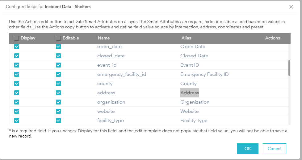

I am trying to change the alias of an attribute field in Smart Editor, in this case, to make Address into Full Address. I read around that you can just double click and change it, but I can't get it to work. Am I missing something or is this not even possible? Thanks

Hi @AFackler_NAPSG ,
As @SethLewis1 said above, this capability is not available in Smart Editor, you will need to make the change in the web map pop-up configuration or in the feature layer item settings.

Try changing the field alias in the supporting webmap. That change should be reflected when you re-load the application.
