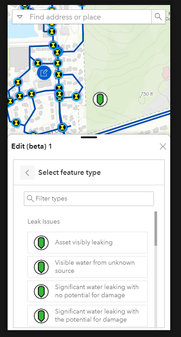

One more option that may be considered is using both the Map widget and the Edit widget together in an Experience Builder application. This would still provide an intuitive map for the users, along with the ability to create a "form" experience by grouping fields and adding field and group descriptions in the Edit widget.
This video demonstrates the new Edit widget: https://youtu.be/BLjwvTDnLlA?t=115
It is also shown in this blog: What's New in ArcGIS Experience Builder (September 2021) (esri.com)
Keep in mind that the widget is still in beta which means there could be some breaking changes in the next releases.
Experience Builder also allows you to configure your app for a mobile experience. For example below, without going into all the configuration details, I've recorded creating an application with the Edit widget and using it on mobile.
(view in My Videos)

I have actually tried the new Edit widget in Experience builder, but the feedback from testers were that they did not understand the words "add feature", or add "geo-objekt" as it says in the norwegian version, which most of our users will see.
But the Edit widget solution comes close to what we are looking for, as does Survey 123 also, we now need to continue testing and exploring.
