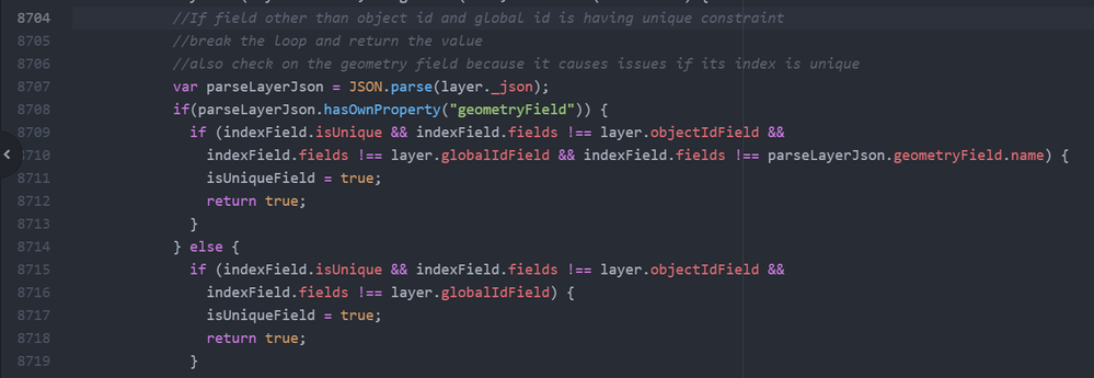

@AaronNash__GISP  There may be one more hands-on workaround if you are willing to modify the code in the dev edition 2.23. The field tied to the unique index you have identified above would need to be skipped in the code. The change would need to be made in the Widget.js file in the section starting on line 8709, in the custom widget you will be importing to your Portal.

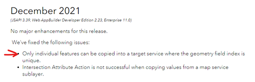

Ah yes it is possible this was due to an issue we have fixed in December, which occurs sometimes with services published from ArcGIS Pro.
 The Smart Editor Widget: A Few Years in Review - Esri Community

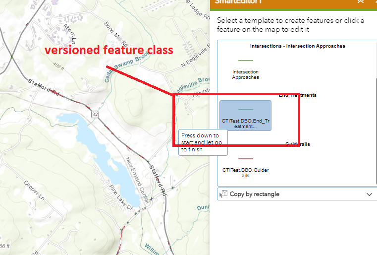

Hi, one last limitation we were wondering about. We were tested with unversioned data with the WAB builder Developer smart widget in ArcGIS Enterprise 10.9.1 and the create features button was there, we tried with a versioned feature service and the option disappeared. Is this correct that this option is unavailable with a versioned feature class?

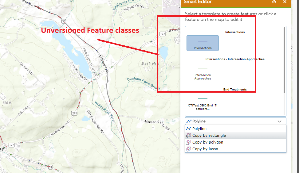

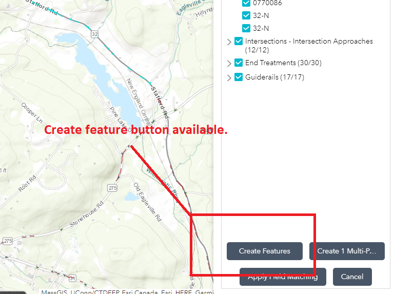

when you copy feature with the unversioned feature class you get below.
This feature class is versioned in the database and stored in SDE.
when trying to copy features to this feature class the below image shows the behavior

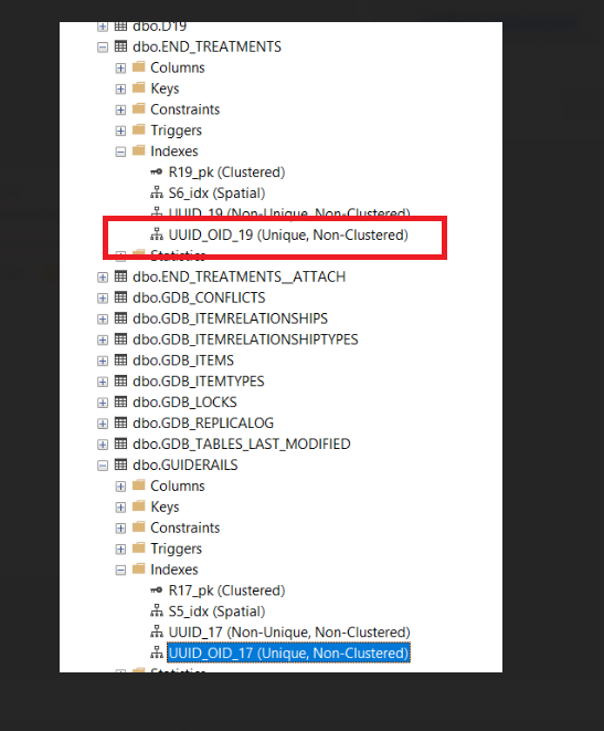

Hi, thank you for the detailed response. We are still unsure about the unique vs non-unique indexing and how it affects our workflow. We found that when you version a feature class it creates an additional unique spatial index. We deleted that spatial index in SQL and the create features button is available, we are unsure of the downstream issues this could create.
